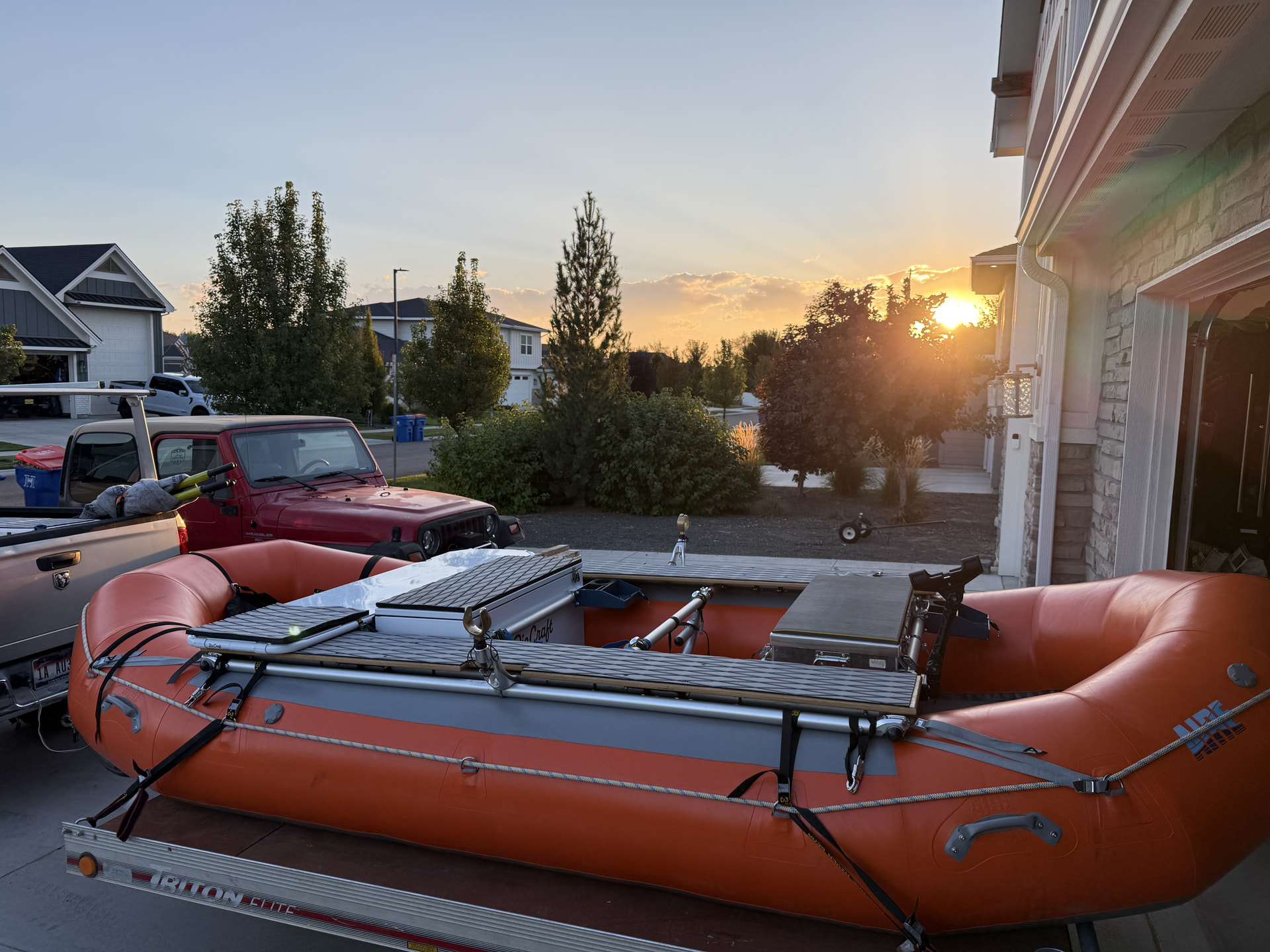

I decided that I’m okay having different frames for day trips and multi-day. Unfortunately, that also means you will start with things that will change. This is my multi-day setup.
The nice thing about NRS Frames is that they are modular. I started with a 60” wide Big Horn II Frame that I initially used on my 14’ boat. When I added my 16’ boat I was trying to save a little money so I turned it into a double rail. I made the deck boards out of white oak and covered with EVA boat flooring foam. I don’t know if the oak is lighter than diamond plate; but was easier for me to work with. White oak is good in water especially after 3 coats of spar-urethane. I love having the deck boards; but they do add weight. I like to fish so the boards make it possible to stand and move around the boat in calm water. I used two seat mounts by Better Mounts to attach each deck board. I don’t like strapping stuff to the deck boards behind the front dry box; because it hinders my oar shipping and defeats the purpose of standing on them. Lastly, I find it easier to get in and out of the boat with the boards. Rails are hard on my knees.
I have a Rio Dry box that I really like. I opted for the single hatch to keep it simple. Plus, I didn’t want the tray from the dual hatch rubbing when boats are stacked on top of mine. I also have a tray that holds a water bottle and some small items in calm conditions. I’ve since added another Rio box to replace the front Cambridge box in the photo. I used the same EVA boat foam over 1/2” closed cell foam for pretty comfortable seating. I wanted to be as low as possible with comfortable seating.
I prefer Canyon coolers; but I didn’t have room for it in this configuration. I’m 6’2” and need enough room for my legs. I’m using a Yeti 110 instead (not pictured) because it’s narrow enough. Behind the rear box is a drop bag that fits 3 milk crates perfectly. In each of the milk crates I can store two ammo cans vertical and one on its side (9 total). Those are covered and held in by the table.
I put an NRS Canyon box that holds my kitchen stuff on top of the table and that gives me something to lean back on if I want.
In the way back, there’s a mesh cargo shelf that carries our dry bags and a 3-gallon water cooler.
In the rowing bay, I can have 1 or 2 scepter cans in slings for water.
This is my setup. It works for me until I decide to change it again. I acknowledge that it’s heavy and there’s probably lighter options. My buddy has a Recretec break down frame that holds two dry boxes with aluminum diamond plate runners. It’s much lighter than my setup; but it’s fixed and cannot be changed.
Thank you so much for sharing a photo. That’s a nice looking set up. I don’t personally use deck boards but if I did I’d want them just like yours. I’m also super jazzed on your seat and the seat paddling. Nice work!
With your oar locks mounted on the outer rail I bet you need really long oars. What is the distance between your oar locks? What length oar are you using.
The oar locks are 78” wide. When I added the outer rail, I did in a way that I can adjust wider or narrower. I used your formula to land on 10.5’ oars. For now I have extensions on my 9.5’ Cateract oars. There’s too much flex with this length and the added extensions though.
