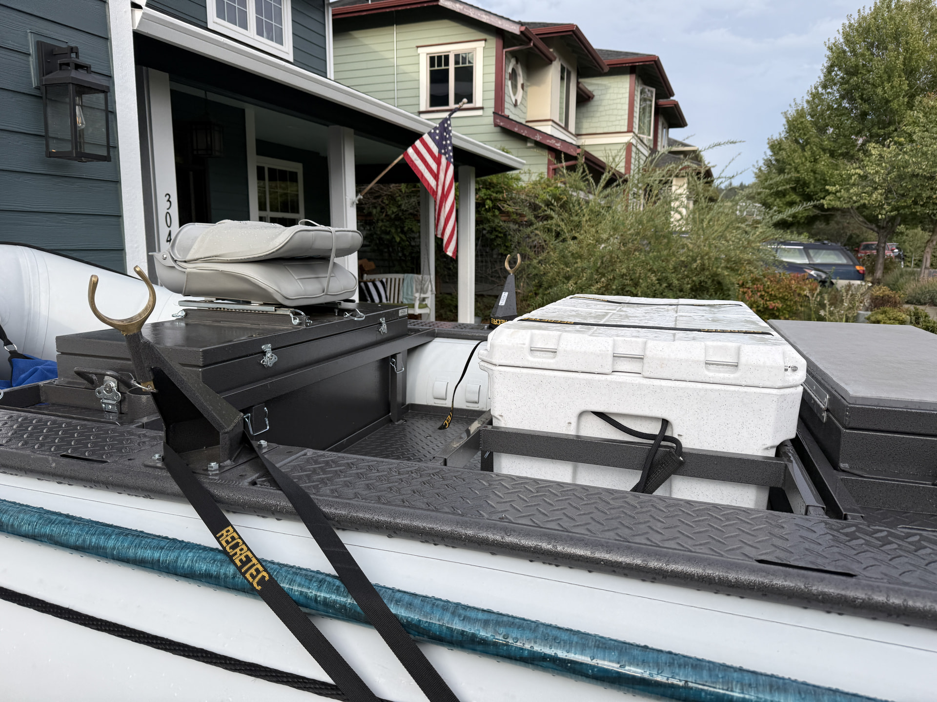

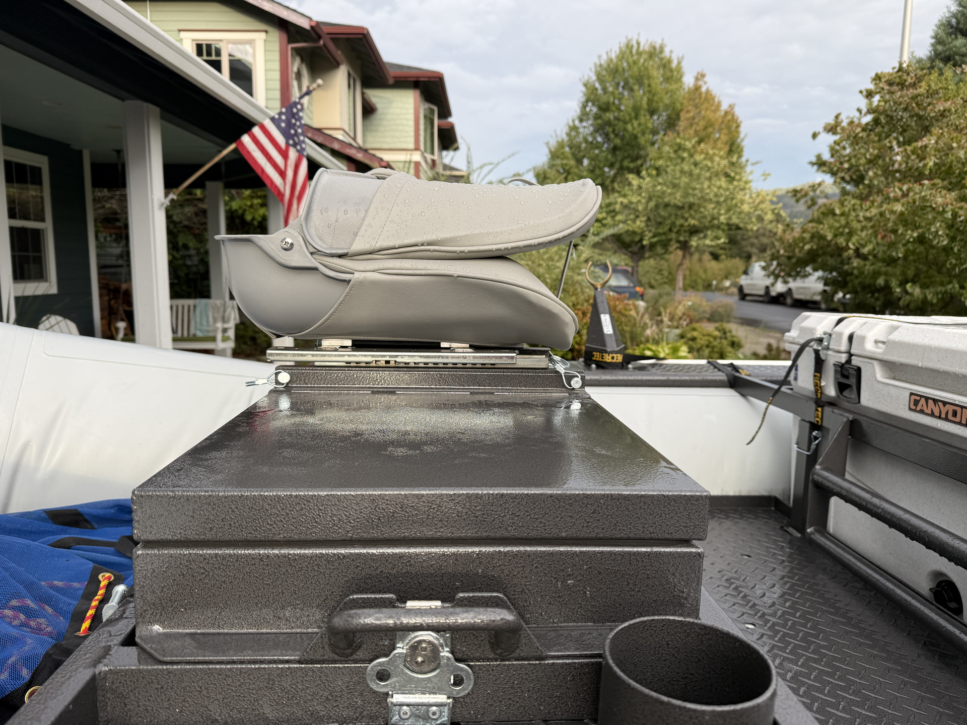

One of the most important design principles is to sit closer to the frame. I would avoid high seats like the one show in the photos below for 2 reasons:
  • If you sit too high the geometry changes making oars are too low to get good power from your chest and back muscles
  • Frame manufacturers try and handle this by raising the oar towers but that (a) increases the difference between the oar locks which uncomfortably increases oar length and/or (b) changes the rowing geometry in a way that makes it hard to get efficient oar strokes.
I would choose to sit right on the box. The seat mount and the seat raise the rower by about 6" which results in taller oar stands which creates other problems.
