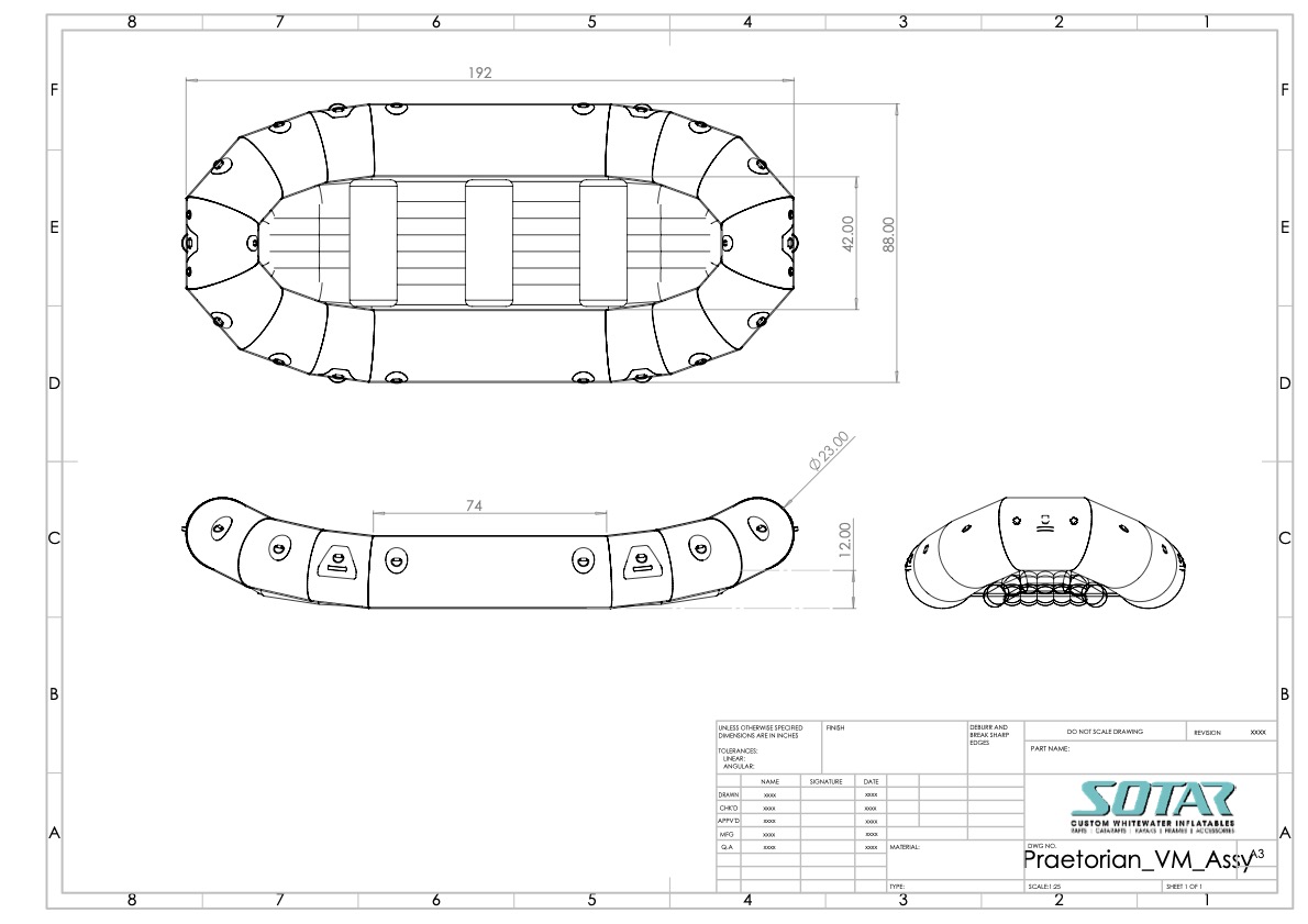

Here is the design for a new SOTAR 16’ raft (Praetorian) that I just designed as a multi-day raft based on the classic AVON Pro.
The straight section is shorter than some frames but it’s fine to have the frame extend past the straight secton.
22inch tubes I am assuming?
23” tubes. Less likely to wrap or flip and handles weight better.
That explains the internal dimensions more knowing the tubes are 23 inches. Looks like a rock solid gear hauling boat design.
